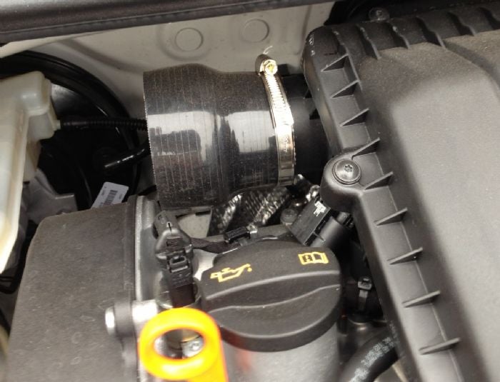

A neat and cheap mod that brings out a throaty tone. I took off the air silencer (bigugly plastic thing)from the airbox (just two tabs hold it into the aluminum airbox) and sourced a rubber pipe adapter from ebay that I clamped onto the airbox with a hose clamp. Really adds some nice sound if not a bit tractor like at times. Cost me less than £5 and can be changed back in minutes.
The seller is "tuningpartsbay" and the item is listed as a "reducer silicon coupler hose tube joiner pipe and you select 2.5"-3".

what about water ingress etc?? the long plastic pipe is there for a reason, also will the shorter one not just suck in all the hot air from around the engine actually losing a wee bit of your precious horsepower?

You still have the panel filter in between the inlet and the throttle body, so water ingress shouldn't be an issue.
Hot air intake is better for MPG though, so if you're not worried about losing a couple of BHP you'll get even better fuel consumption from the up!

Please - there is loads of airflow thru the Up nose, water had more chance splashing up into the long snorkel than reaching the intake in this setup.Why don't you naysayers who want a bit more engine note just unsnap the silencer and try without? My little velocity stack is more for looks tha naything else. And before someone says it you still have the factory airbox/filter - though I've put a K&N element in mine......
