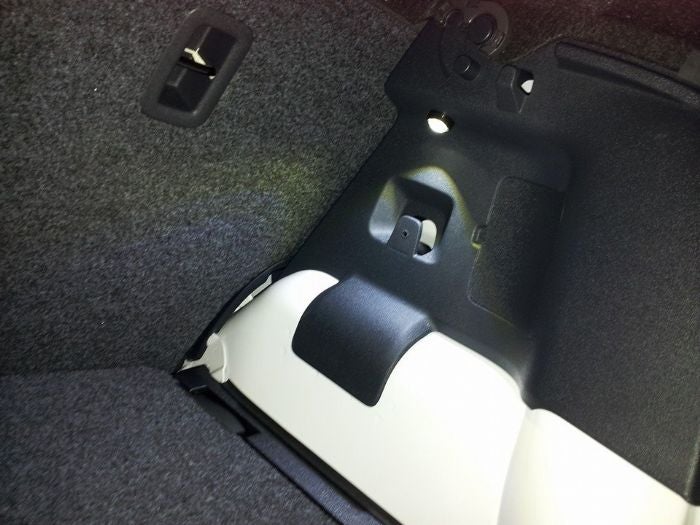

Finally, I had the time to install boot light in my Up!

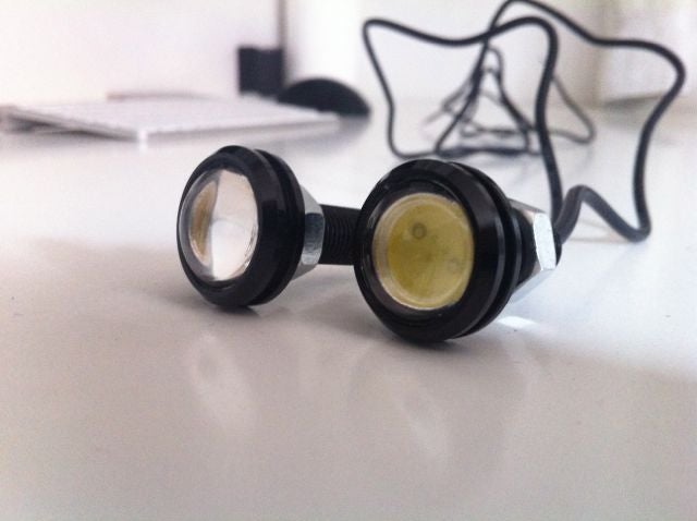

I have used small LED lights, and installe in both sides of the boot. They put out plenty of light, compared to the size of them.
They are connected to the roof light, just above the rear mirror, so they only come on, when you unlock the car, or open one of the doors.

This is a great idea! but why didn't VW fit something like this as standard? do you have to remove the head lining to run the wires up to the light?
knjdk said:
Hi. No I just removed the roof light and then ran the wires between the roof and the roof liner. I used an old tape measurer since it is rigid but still flexible. When it was through, I taped the wires to it and could then pull them through.
You are a genius..!!

<div style=": rgb251, 251, 253;">1 - I bought 3W eagle eye LED from ebay
<div style=": rgb251, 251, 253;">2 - read this post to get some clue how to wire the boot LED, so it should work the same as interior light (same switch adjustment)http://www.upownersclub.co.uk/forum/w8-fitting-instructions_topic3661_page1.html?KW=w8+interior
<div style=": rgb251, 251, 253;">3 - I was to lazy to take all ceiling trim off, so I connected LED, checked if it works, because + and - need to be correctly connected. Then I slipped the wire all around the ceiling trim, so it was only some 2cm inside (just to hide it). Hardest part was in the rear, as plastic side trim needed to be partly taken off for the wire (don't be afraid to pull a bit harder, it's pretty hard to damage such robust plastic)
<div style=": rgb251, 251, 253;">4 - partly took off the boot plastic where LED should be mounted, drilled a hole, installed LED and connected wires (I had LED with short wires, if You take with long wires, You need to do installation all the way around to avoid cutting the wire)

Bought mine on Amazon. However, they came from China, so delivery took longer than expected!I bought two pairs for £6.19 - Just search for "4 3W LED High Power Eagle Eye"
Very bright, and light up the whole boot.
