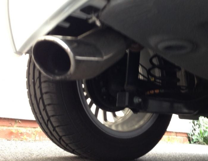

Bought this chrome exhaust tip for my Up!
It is a little sloppy as the Up! exhaust pipe is only 38mm so I took a small metal strip and bent it around the exhaust to shim the fit a bit - it also helps to geta good angle on the pipe. Pic doesn't do it justice - it's a quality part, a bit heavy but good chrome.
It is on ebay for under £15 from "crystal_edge" and is listed as a
"chrome racing uplift exhaust tip 35-45mm"
22 Posts
Discussion Starter #2
Oh, and to get a tight clamp you have to hacksaw down the clamp enda few places ((i cut down about 1.5 inches) and use a good muffler clamp. The supplied holding screws just won't cut it! I even put a small safety wire from chrome tip to car so it could never come off.
