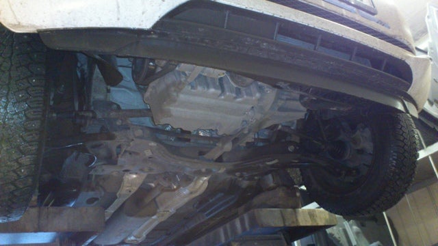

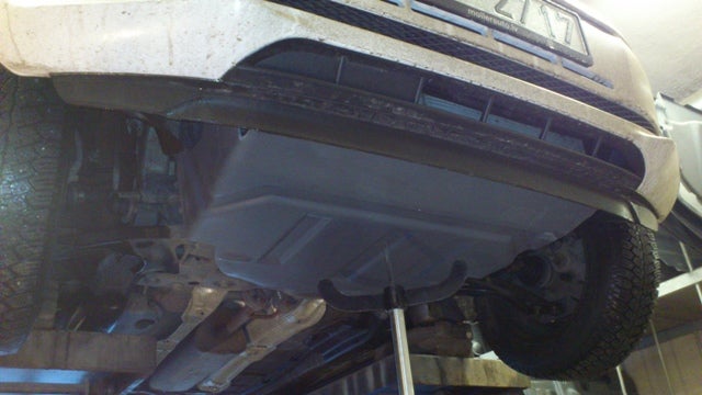

As engine is opened and dirt can get on the timing belt...
...I have visited guys who make engine guards. Specially on my Up they have designed and after 1,5 months produced it. Today I got it installed.
Customer price around 70 Eur. And this is not the cheap plastic, which will fall in to peaces after first bump/ rock.

Details:material - 4mm glass fibre (not a cheap plastic)
fixing points - 5 (6mm steel bolts fixed in car frame made fixing holes/ 2 in both sides, 3 in back)
My wish was to have two "ears" (one on each side), so the dirt/ mud doesn't get on the engine and timing belt:
company who makes such guards is called RLM, here's the web site:http://translate.google.lv/translate?hl=lv&sl=lv&tl=en&u=http%3A%2F%2Frlm.lv%2Flv%2F
You should write an e-mail and ask if it's possible to transport it to UK. I think, the main issue is the car preparation with fixing points on frame.
I have asked my colleague who is responsible for VW warranty in Baltic's, he said, that the only case when warranty won't be valid, if there will be some rust on fixing points.

467 Posts
Discussion Starter #15
They installed a planch for each mounting point, each planch was fixed with 2 rivets to the frame.
The planch have a hole with thread for the engine guard fixing bolt.
