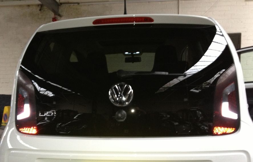

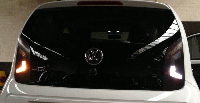

gary02tdi said:
Ordered a pair of these....
http://www.ebay.co.uk/itm/2-x-13-SMD-Xenon-white-LED-bulbs-R10W-1156-BA15S-245-sidelight-/230850557126?pt=UK_CarsParts_Vehicles_CarParts_SM&hash=item35bfc3f4c6
Got them fitted today.
Left side normal bulb
Right side L.e.d.
Sorry about fuzzy photos (Iphone and the flash fired)
I have also bought such a set.. It looks good, but when I put the car in reverse, and then run forward, the reverselight blink every now and then..<div style="line-height: 16.7999992370605px;">If you then turnthe caroff and on, there is no problem until I again put it in reverse..
