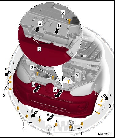

During my holiday I'm trying to upgrade my up! with some small changes. I wasn't happy with the white background on the front logo, so i decided to make it black! Iacquired some black adhesive film from the local graphic shop and started the dismantling!
First you need to loosen the three Torx T25 screws (#2 on the picture below):
Then you loosen thefour bumper hooks by pressing them while pulling them bumper out. They hooks can be reached through the four holes ("B" on the picture above):
The logo is then removed from the the back side of the bumber. As you can see on the picture below, there a quite a few hooks! And not only that, they are glued as well!
You can easily see where the logo has been fitted
Fitst I cleaned it with soap water, then withisopropyl alcohol, and finally wiped it with a microfibre cloth - then we're ready to go!
Haven't got any pictures from when we applied the film! But there are LOTS of tutorials on Youtube. I soon found out that it was not that easy to apply on curvy surfaces. Got my girlfriend tohelp me out - really appreciated that!
And finally: A white up! with a black nose! Perhaps i shoul call it Snoopy!
