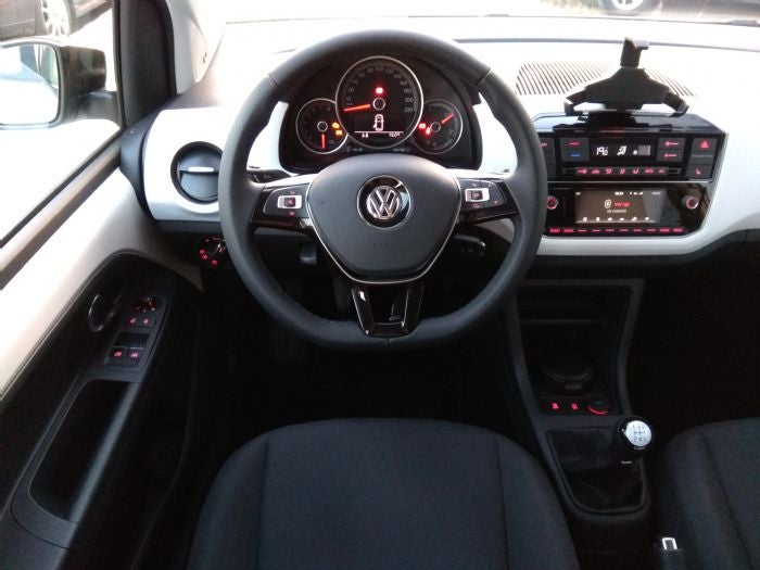

Hi to all members. I am nick from Greece and this is my new eco up 2017 model with full of extras. The magic part of my car is the cng.

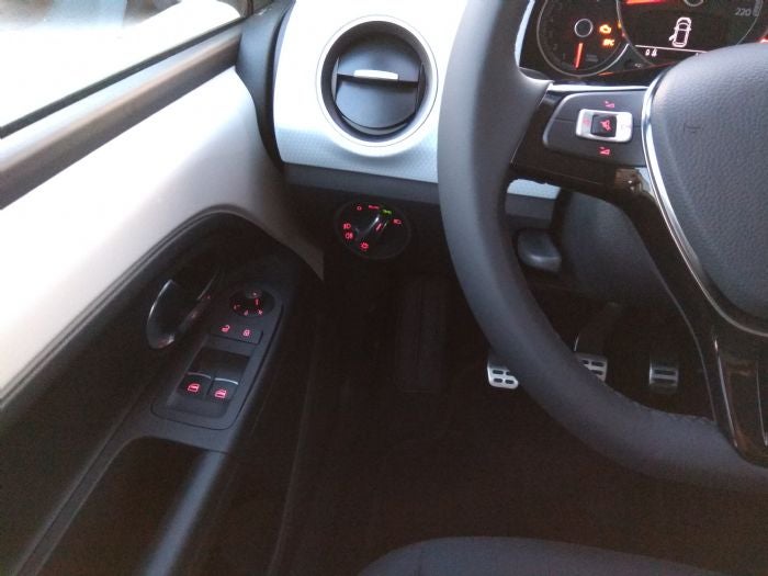

All vw up have non illuminated switches at door panels. So i secide to install illuminated switches from other models.

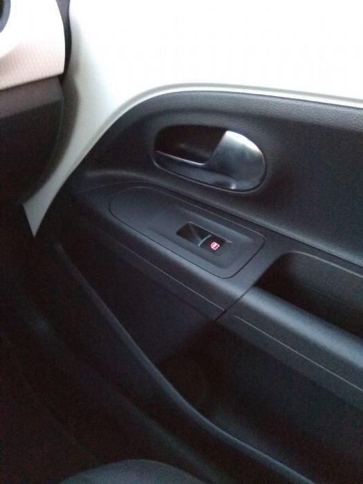

I start firstly with window switches . I order from ebay 3 switches from golf 6. Install to switch board a led and 680ohm resistor and switches transofm to illuminated. ( there is another forum member has done this mod with oics)
Secontly i order a vw polo 2011 mirros illuminates switch and it was plug and play ( just run a 12v cable to empty pin of 10 pin connector)

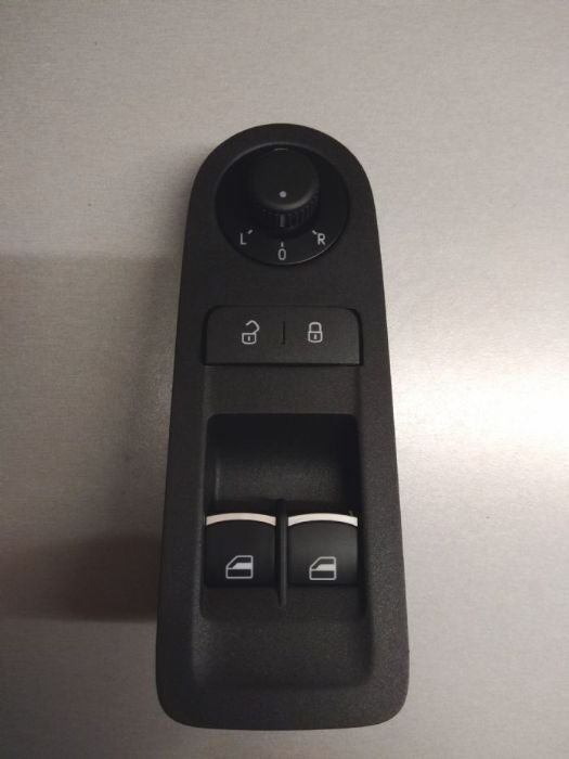

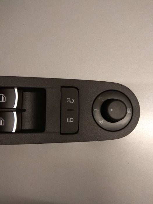

The latest lock/unlock switch was from transporter t6 with part number 7E0962125b . This switch is factory illuminated similar with oem switch. Rear blue connector fits perfectly but the switch frame needs to be cutted some mm each sides. For illumination need to run a 12v cable to pin 2 .
Also i add to interior a w8 interior dome light with ambient lighting modded with white leds. Result is awesome!!!

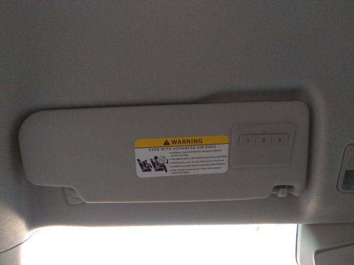

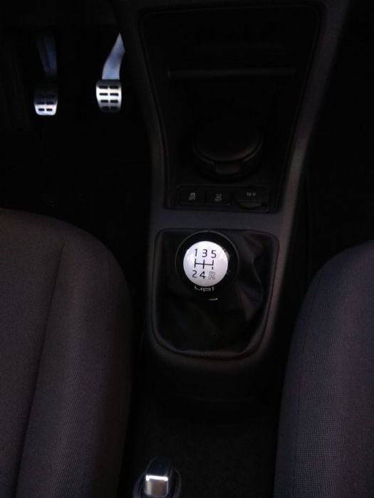

Yes mate, audi pedals and oem homelink sunshades from us jetta 2013 model
Small mods but good looking

Amazing.VW should be ashamed of themselves for not making switch illumination standard. The driver's need to be able to identify controls in the dark applies regardless of trim level - let alone leave it to the enterprising owner to DIY !
84 Posts
Discussion Starter · #8 ·
Vw make this to reduce the cost of the car. So its a car of DIY
The new lock/ unlock switch is not flat like oem vw up switch.
Has a small step at one side and you can fell it better with your hands.
For me has better feeling from previus one

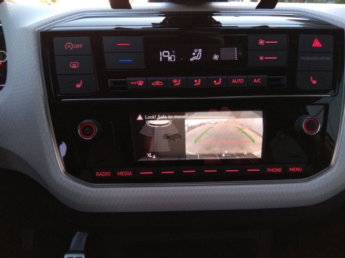

I bought a pair of focal coaxial speakers
After instalkation fadder logo added into menu and sound is much betrer
Also add some center console ambient lighting....

I run cables from radio unit to back doors Through back door connectors and after speaker installation the unit needs reprogramed for rear speakers. Then tou can see the fadder logo at menu. The speakers are focal for vw cars. With factory shape amd factory connector. Plug and play speakers.
