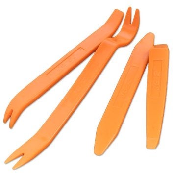

First of all you need to remove the glass which isn't much of a problem, you'll just need the trim removal tool on the far left which you can buy from ebay for a few quid.
Just wedge it in and prise it off the clips making sure you don't flex the mirror too much and break it.

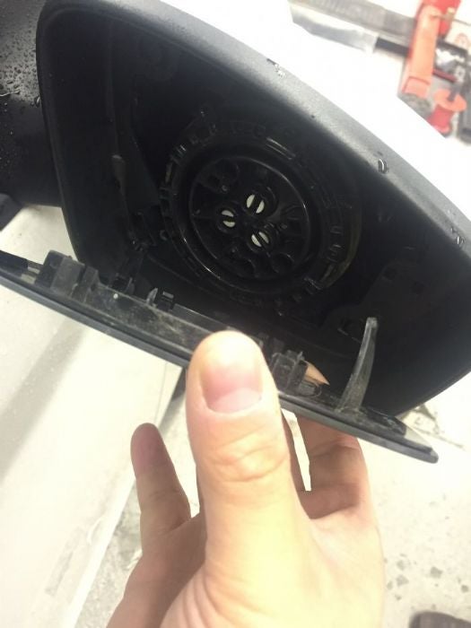

Once that is done your left with the outer ring shell which using the trim tool can be gently prised off its clips, just start in the top location and work yourself around.

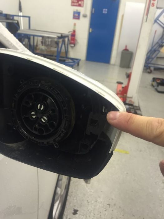

Now that's done, you can see a clip which needs to be pressed in and the rear cover is removed.

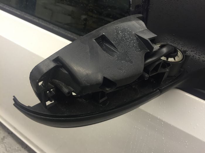

With the covers removed you should have access to other parts of the wing mirror assembly.
