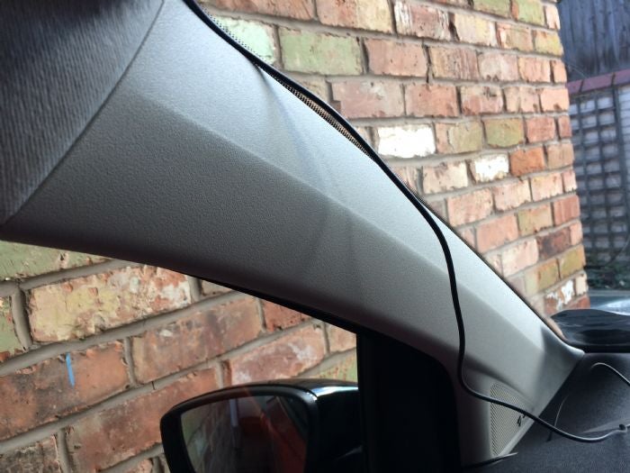

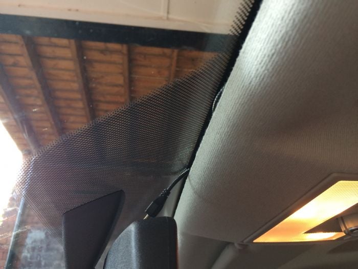

I had a rethink on how to fit the camera and how have some tips that might help you have it neater.
You can tuck the wire in at the top of the windscreen between the headliner and the glass, it seems to stay there on it's own. Then if you run the wire over the top of the A Pillar trim (you can sqeeze it behind the plastic between the headliner and the trim). The cable can then hide inside the rubber door seal if you pull it back and under the glovebox, or if you're going on the drivers side, through the dashboard by removing the cover for the drivers side fuse box.
If that's not clear let me know and I'll take some photos!

I have routed the cable above the windscreen and pushed it behind the head lining up to the door pillar. Then at the plastic trim for the A-pillar i have come back towards the door (between the top of the plastic trim and head lining). Following that, down the door rubber (Between the rubber and A-pillar, rubber flaps up) towards the bottom of the glove box and into the glove box where I have a multi-plug.
